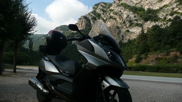

Petite pause, rapide check-up visuel, pipi, glouglou, etc...
